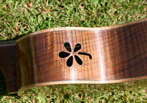

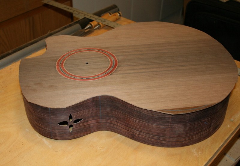

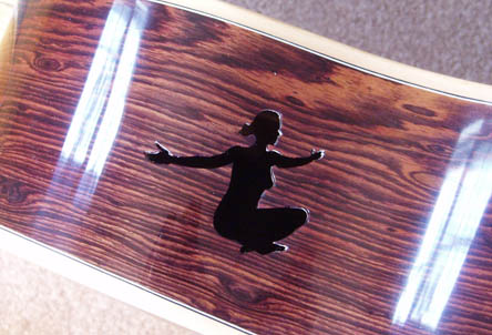

Here's a couple I made.
One is in the works and the other was on my wife's mother's day present!

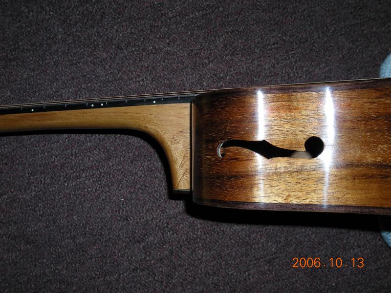

Here's my last one on the irish bouzouki
Those are all great looking sound ports!

I did this one on my last SS. I cut it with a dremel w/ Stew Mac router
base, after bending, but before attaching back and top. I cleaned it up
with needle files and a jeweler's saw.
